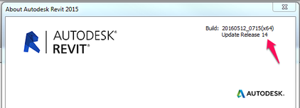

It concerns all the materials. Create new material or changing the material identity to a different category, don't help. Do you know how can I check that I've the latest service pack for Revit?

Ok I found solutions. In aplication programs and functions clicking one on Revit 2014 and leter clicking deinstalation/chenching. Next clicking add or deleate components. Next mark everything in our language and install. Its help me.
Lower screenshot.
