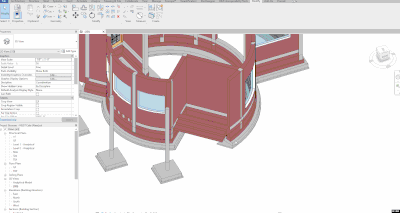

I have joined two foundations and they form a miter join. When I want to put Free form rebar in it, it gives an error and asks to check the constraints. Is there a way to change the join type?

The issue you are having is not related to the join type... see GIF below, using free form rebar
Aligned
Or by Surface

The error is related to the reinforcement settings not the foundations although they could use some clean up (join geometry and join order)
The primary issues causing the error are the following:
  1. Bending Diameters and constraints (You have set Bar #4 to be bent 3" dia...with the Path Start and End constraints set to 0", Revit will not be able to bend the bars) - Solution:
    • Select rebar >> Edit Constraints >> Give the Bar Handle: Path Start/End a negative 4" offset
    • Edit Bar type and reduce bend diameter if possible (for a Bar #4 you should be able to work with 2")
  2. Wrong Cover Settings. You are using Bar #4 BUT you have set the cover for Bar#6 to 18 - Solution:
    • Select the foundation >> Set the proper Cover settings
    • GO to Reinforcement Settings and adjust cover if needed
See GIF below
Part 1
Part 2

Here's my suggestion: Select the Single Bar and Edit Constraints and inset the Path <-1' 0">  at both ends.  Press Finish and change Layout to Multiple. Bada bing. No other changes necessary.
Too easy?
