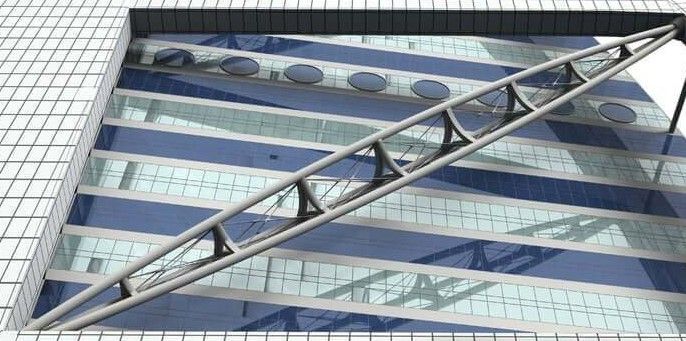

Just made this and it is similar.

thanks for your great work.... wish to see the tutorial how you create that bow truss 🙂
and also the front I(white) facade
