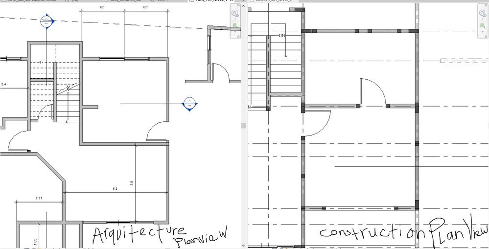

Hi, Revit community,
Could you please give me some advice on how to set up the elevations? I'm kind of stuck.
This is a house made up of concrete masonry walls, precast concrete beams, and precast concrete columns.
I joined all the columns with the walls and tweaked the visibility graphics so that I can have a flushed wall in the architecture plan view and the columns visible in the construction plans.
However, When I open the elevations I get lost on what I have to do in order to have the walls flushed. All the beams and columns join lines are visible in the elevations I tried to set up the visibility graphics but could not find the option to hide the columns and beam lines.
I want to apply some materials in some elements on the elevation, and 3d but with all those joins it seems very intimidating to be honest as I cannot continue with the project 😞
Is there a Revit way on how to fix it? or what are the settings to take into consideration?
there should be an option to hide all the inner joined lines at once.
