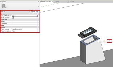

I didn't expect to be doing too much of this, but I find myself with a few void extrusions like the one below:
which I've left as their default names.  Some of which are walls and others ceilings.
I can find them using the rather laborius way of searching through the family tree but I can still have multiple wall voids named Wall 1, Wall 2, Wall 3 etc and I've no idea which is which.
Is there a way to find the name of a void when you click on it?  Like in the image above, I have it highlighted but I don't know what it is called..!!
I was hoping the name might appear in the properties tree but no such luck 😉

Hover your cursor over the void and a tooltip will show up next to the cursor showing the element category, family name, type name. This also shows up in the bottom left of the Revit window.

Funnily enough they don't. I tried a couple of different model in place elements and the name doesn't show up in properties even if you name the family/element when it's created.
The only renaming option I can find is in the family section of the project browser.

@barthbradleyThis is what I get in the properties windows after selecting the cutout:
Ordinarily I do name things appropriately as I'm going along (unless it's just a rough test piece just to get the hang of a particular feature in which case it gets scrapped afterwards!!) but I wasn't envisaging having more than one and then things got carried away.......
