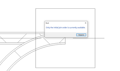

protsencko_mikhail
I've tried this tool but it doesn't go from tangent connection to an angle connection. Also, I used join geometry tool before using wall joins becouse otherwise wall joins tool would not work at all.
