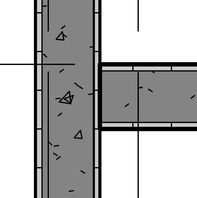

How to connect walls and floors in this situation?
How to connect the concrete on the concrete and the isolation on the isolation?

If the materials are the same, and the geometry of the materials is in contact, the intersection should clean properly with Join Geometry.
Nachricht 3 von 9
als Antwort auf: Alfredo_Medina
Yes the materials are. And 'Join' does not work well.
Do you know which mistake I probably made?
Nachricht 4 von 9
als Antwort auf: Anonymous
You need to extend the boundary of the floors to meet the structural layer of the wall.
Nachricht 5 von 9
Alfredo_Medina
Revit is not drafting, it's kind of like building, but virtually. If your concrete is not in contact with the other concrete, how is it ever going to join?
