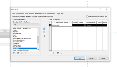

RDAOU
@gustavobernardi
Depending on the version of Revit you are using (2022 or later), Sill Height can be added to the tag and/or used in a calculated value in the tag. Hence the same principle I mentioned in the previous reply, you can use in a window tag
gustavobernardi
That's it!
I'm using 2025
Thank you!
