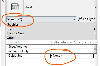

How to remove them from sheet but not deleting them. I will use it later on and already using it on different sheet?
Thanks mate
Thanks mate
Highlight a bunch of sheets in your project browser and set Guide Grid to <None> from Properties.
ahmadM69EF
Thanks mate!
