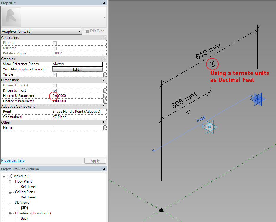

Can anyone explain why it looks that, in the conceptual environment, the Hosted U and V Parameters are using imperial units in spite of the fact that the Project Units are set to metric?
This is found at least in Revit 2016 and 2017.
J

If you look at the image in the post the U and V values show "1" while the dimensioning of the Point shows 305 mm. It is rounding the 304.8mm.

These points are constrained to the YZ plane.
Whenever I try to move the points to different places their distance to the origin measured in feet always matches the U and V parameter values.
File attached. Do they show different values when you move them?

Looks like the metric adaptive template is not built from scratch but based on the imperial one.  there is nothing you (we) can do about it except for requesting Autodesk to fix it.
For now, you can manually enter in the value you need divided by 1 foot, which is equivalent to enter in the value for the dimension in the model view.

I take my previous statement back. The value does work in decimal feet, even in the metric template. You are right on that. Is this an inconsistency? Yes.
Having acknowledged that, however, I do not think the units are very important or useful in this case, and there is always the chance to convert one unit to the other if that is necessary. The reason for my comment is that points are not usually driven by linear dimensions in this template. The U V parameter refers to grids in surfaces, not in linear dimensions as in the example posted in this thread. Notice, in the image below. A value 0 and 0 for U and V in a circular surface puts the point on the center, regardless of the units. But, in an irregular surface, a value of 0,0 puts the point at one corner of the surface? Which corner? left or right, up or down? it depends maybe how the surface was made.
