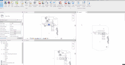

RDAOU
@cadedu22
You need to go to VG first and uncheck the revit link then create the view template
Check/Open the GIF added to Message #2 above... it shows how to create and apply the view template
cadedu22
Ah, now I get it thanks,
