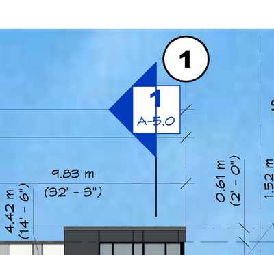

I'm in revit 2023.
I have a section head that i would like to add a white background to so that in my coloured elevations it is white and masks the sky background behind it to allow for clarity to read the references.
When i try to use a filled region it goes completely blue, covering my text.
When i try to use a masking region it makes the background white but the line that i have in the center
disappears from view and there is no send to back or front buttons in the family editor.
When i tried to make 2 masking regions so that i'd have a line using one of the edges, the line doesn't rotate. How would i ensure these 2 masks rotate as well? image for reference included. I think this is the way i should do it but if there are other workarounds let me know.

Ryan_GormanKT36T
Try some of the workarounds mentioned here;
Solved: Draw Order in Generic Annotations - Autodesk Community - Revit Products

pcoba
Hello, I used a nested generic family with a text parameter, long short story I attached the family for you can check it, regards!
Section head with line and white background Revit 2024
