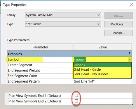

Alfredo_Medina
@Anonymous
Welcome to the forum.
Perhaps you don't have any grid head symbols loaded in the project.
The other reason could be that these other two parameters are not checked: "Plan View Symbols End 1" and "Plan View Symbols End 2". If these options are off, the grid will not show the bubble, even if the "Symbol" parameter is not set to "none".
