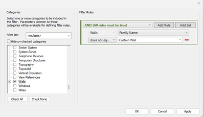

GaryOrrMBI
Instead of directly overriding the wall category in the views and/or view templates create a filter to and use the filter to assign the overrides. With a filter you can have it exclude walls with the Family Name "Curtain Wall":

EdMilbourn
Many thanks. Exactly the solution I was looking for.
The only downside is I'm using Revit LT which does not offer filters - a crazy decision as filters seem a fairly basic graphic function.
I understand the exclusion of the more complex BIM features but view filters!?
Regardless of this, thank you Gary.
