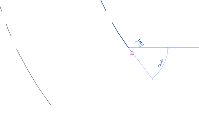

I have curved grid lines. I have been able to place a radius dimension on the innermost grid. Rather than place a radius dimension on each, I'd like to use an offset - dimensioning the space between the lines. Revit does not seem to let me do this. Am I missing something? I could understand if it's because it's curved, but the distance between the 2 is always the same, it would just have to find the perpendicular.Seems to be that "alined" dimensions should work, but I've also tried linear with no luck.

It seems I wasn't clear enough with my question: I'd like to dimension the offset between 2 curved grid lines. Using your example, if there were a curved 'B' grid, say 5'-0" off the 'A' grid, it won't allow me to dimension from A to B. Any ideas on this?

I've attached an image of what I'm trying to do to clairify, the curved grid lines share a centerpoint, and are always the same distance from each other. One is simply offset a distance from the other. I want to dimension that offset.
In the attached: Grid line 'C' has a radius of 73'-11" from the center point. Grid line 'B.9' has a radius of 78'-11" from the same center point. I simply want a dimension of 5'-0" between them at a perpendicular - which 2 concentric circles have, in the spot I marked red, but Revit won't let me do that.

  1. for horizontal and vertical can be used the  Linear Dimension to snap points
  2. for other angles, a workaround can be done : draw a Detail Line or Model Line ( using SP - Snap Perpendicular to the second arc) , these lines allow Aligned Dimensions to snaping points ...Then, make invisible that line using a Filter of color...as shown in my screencast...

That was a good suggestion by Constantin . I have used reference planes instead of detail lines at the end of the grids to dimension the offset. As reference planes can be excluded from printing the filter step can be avoided.

Draw a pair of short detail lines, tangent to the curved grids, and then dimension that pair of lines
