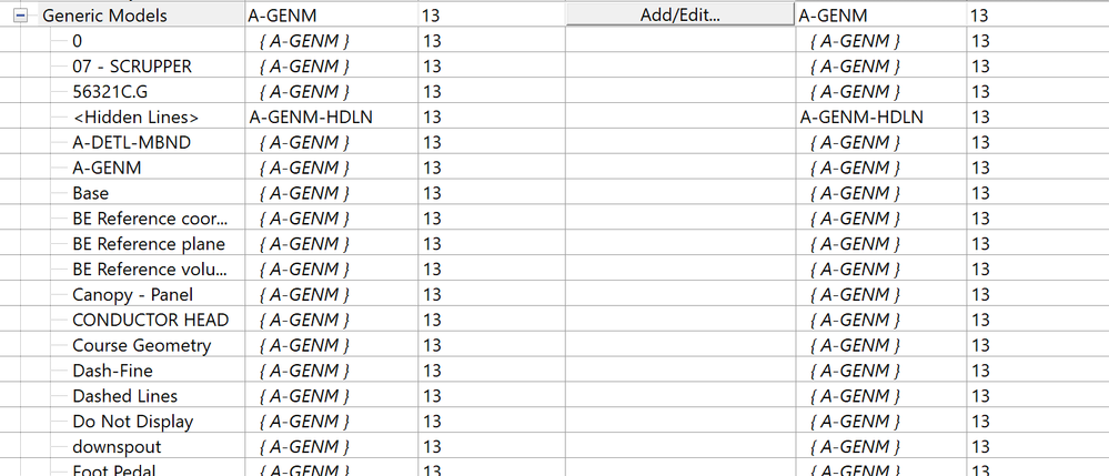

For some reason, when I export revit views or sheets to dwg files, any generic models export as colour 59 in Autocad, making them nearly invisible on autocad's black background. I've looked at the dwg export settings and set all generic model projection lines and cut lines to export on a specific layer (A-GENM) with a specific colour (13). When opening the exported dwg files, the generic models are exported as blocks on the correct layer, as are the lines within those blocks, but the properties of the blocks and all lines within them are set with a colour override to colour 59. This happens to any 3d elements in generic model families, but not to model lines within those families. I have looked through the entire set of export options, and I cannot find even a single instance where colour 59 is set. Why is this happening and how can I fix it?
Shown here is a sample of the dwg export settings for generic models in revit.

have you checked what your Export Layer Options settings is set to? try the "Export all properties BYLAYER but do not export overrides" option.
Howard Munsell
Message 8 of 9
rebar_eater
Yes, this seems to have worked! Everything is exporting in the right colours now, thank you!
