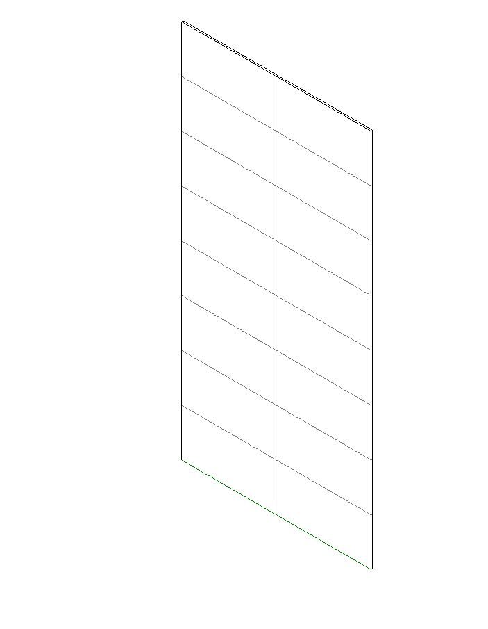

I have created a Generic Model Splash back see below, when i bring this model into a project. the pattern is not able to be aligned to the flooring. what have i done wrong here?

How is the pattern made?
Message 3 of 20
You cannot align a model pattern of a loadable family in the project environment.
Message 4 of 20
is it a Model Pattern? I'm seeing edges. Looks like individual panels -- possibly arrayed.  Maybe a Line-Based Family?
Message 5 of 20
It's is an extrusion 10mm thick with a 600x600mm pattern.
Usually i do this as a 10mm wall face and dont have this issue just wanted to have something abit more solid then a wall finish all the time.
Below you can see the bath tiles and shower tiles dont line up and wont allow me to align them.
Message 6 of 20
You have to create them as thin walls or wall sweeps in the project then you will be able to manipulate the model pattern alignment.

Alfredo_Medina
Yes, you can align the lines of the tiles on the floor with the lines of the tiles on the wall. For the floor, use a floor element with model hatch pattern (not a pattern-based family!), and for the tiles on the wall, use a thin wall type with a model hatch pattern. Then, align the tiles.
Message 10 of 20
FAIR59
the alignment can be realised by an offset parameter in the family.
In the family:
  • make a reference plane (horizontal).
  • give the plane a name.
  • give the distance to the Ref.Level a labeled dimension.
  • set the workplane of the extrusion to the reference plane.
  • align the surface pattern to the reference plane.
  • constrain the pattern to the reference plane using a locked dimension.pattern_offset.PNG
