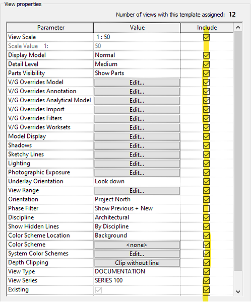

hello there,
we have a project where the furniture, casework and plumbing elements from a linked model are showing with different outline colours on different floor plans. see image attached (one is white and another one is grey halftone as we need).
-this is only happening on the linked model
-we are linking the model per linked view
-the linked model is showing halftone on all floor plans but when linked if changes
- the families are the same
- view template is the same
-VV settings are the same for all elements.
any clue what can be happening?

Check that the elements you are having trouble with have their settings included in the view template.
Does the linked model use a view template for the plan views? It may have slight differences in colour overrides applied...
