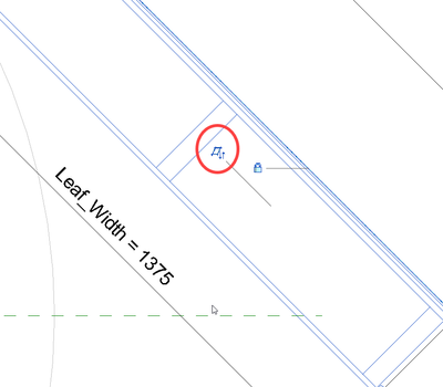

Hey @Intuos5: I think I understand why all the Ref. Line. Gymnastics!  Maybe you weren't aware that you could orient the Panels to either side of the Ref. Line?  This is done by clicking on the Flip Work Plane icon shown in this screenshot:
BTW: I hate to tell you, but your family broke on me.  Panel got disjoined and separated from one another. Maybe you are already working on this.  Just thought I'd mention it, in case you were unaware.

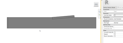

Here is a family from scratch.  Seems to work at any angle.
There is a total of 3 ref lines and 1 additional ref plane added to the OOTB family.  All necessary parameters are listed in the screenshot.
