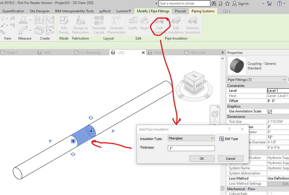

I have created a passive fire protection collar for pipe running through slabs as a generic face based family.
Is there a way for me to set it so that it can adjust size by referencing a pipe?
Would it be possible to set it as a plumbing product and have it assigned to a pipe so I can set perimeters for its size?

Perhaps utilize the built-in functions?
Annotation 2019-09-17 170238.pngAnnotation 2019-09-17 170312.pngAnnotation 2019-09-17 170339.pngAnnotation 2019-09-17 170358.png
Example:
You know, if you built it as a Floor-Hosted Family, you could make your SlabDepth Parameter a Reporting Parameter and have Revit automatically input the Slab Depth that the component instance is Hosted to in the Project.   To do this, just pull a Dimension between the Top and Bottom of the Host Floor in the Family, and label it with the SlabDepth Parameter.  FWIW.
