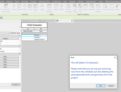

I have a schedule that contains a number of blank lines. Is there a way I can filter the schedule to not show any lines that have blank fields?

If they are blank rows added using (Insert Data Row), you can delete such rows by simply selecting in schedule and hitting delete on the Ribbon.
  • You will be prompted if there are elements related to these rows in the Model
  • I would suggest that if prompted, cancel the delete and check what those rows are before deleting..
Blank rows could also be related to
  1. Field/Parameter which has no value
  2. OR blanks because user have unchecked "Itemize every Instance" and schedule has no sorting
If it is blank rows due to a filed having no value, you can simply Filter using the parameter of that field and set condition Has a Value
