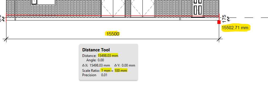

I'm using the inbuilt Title Sheets, but when export them to PDF, and do a measurement of mm in Adobe Reader to make sure they are to scale, the measurement is different.  The scale i'm using is 1:100 and the sheet is A4.
Even when I measure it directly in REVIT sheets, it reads 155.0 cm instead of 15500.  What's annoying is, i had it working fine a day or so ago - but now something changed and I don't know what? 🙄
Any help would be much appriacted becasue I'm so new to all this.  I've attached the screenshot from both REVIT and Adobe.

Be sure that in session size you select "zoom: 100% size" and not Fit to Page.

In Revit, check your Project Units if it's in mm (it's in Decimeters probably right now).
In Adobe: make sure you change the measurement scale in Adobe before measuring. You can do this by opening the Measurement tool and then right-clicking > Change Scale Ratio > change it to 1:100.

Hi Kostask_oionei,
Thank you for your reply. I've tried this, selected A4 etc. but it's still the same. I had it working fine, but something has changed, and i don't know what 😞

Hi @ralphdenhaan,
Thank you for your rely.
I checked those and it's in mm.
but....
This is where I was going wrong! - I changed the Scale Ratio in Adobe as you suggested, and I think you've solved it for me!

It's been driving me crazy! - Thank you @ralphdenhaan for your time and assistance, it's very much appriicated 🙂
