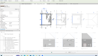

drewyatesC29ZS
I have just started a project set up all my sheet and templates. I thought it would be great to use phase filters to show existing [grey] demo [red] and new [blue]
I set all my existing walls to existing phase with phase demolished as none.
The template is showing 'show existing'
The existing walls are showing in blue.
I have combined phases and made a new new phase because i thought maybe I made them on the new phase. but this hasnt worked.
Any help would to make my existing walls appears as per the phase filter [grey] would be appreciated.
Thank you

Hi Jay,
Thanks for you assistance - in this case the walls are all set up correctly please see the screenshots below - I would say I am a intermediate revit user I have used phases over the last 8 months. The wall below is created in an existing phase and isnt being demolished when I turn the view template to show Existing + Demo the walls dissappear. They are somehow on a new construction phase. Can this happen if the walls were orginally drawn in a GA new construction or paperspace phase?

drewyatesC29ZS
Hey Jay,
Thanks for this -
I have done what you have asked -
It appears the existing wall has turned blue. I.E it is being overridden by the new phase graphics.
The Wall in an existing phase
The view template in Show existing + demo
The phase filter settings for show existing +demo
The phase graphic override - The new phase somehow is sending all elements created in an existing phase blue.

Message 7 of 9
drewyatesC29ZS
Hi Jay,
I think I figured it out.
So the phase is always new construction?
When would you ever use the existing phase?
Message 8 of 9
jay_colc
When you just want to show what was there originally, think of it as a simple extension to a house, the architect will draw up the existing house "Existing Phase" and only show this in a View.  Then they create the "New Phase" (extension) and then in this view it could be New Construction and the Phase Filter would be "Show Previous + New, so you can differentiate between Existing & New. (obviously most people just draw existing as filled regions so just override it)

If you want to show the existing walls as existing, set the view phase to new and phase filter to show previous + demo.  When your walls are created under existing phase and your view is existing then the walls are new in that view.
Also, don't name your phase filter as show existing, name it show previous. It is less confusing.
