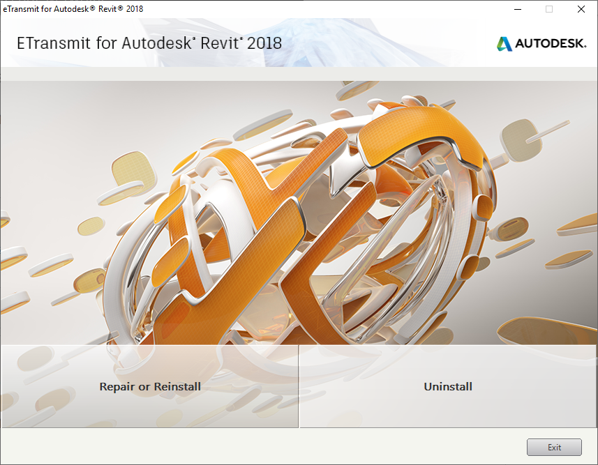

I am trying to figure out why my 2019/2020 doesn't have eTransmit installed, since it is an included add-in.
I have reinstalled both products and they are still not showing on the add-ins tab.
Any thoughts on what I can do?

That's weird. Have you checked to see if it's available as an add-on through your Autodesk Account page?
Do you see it here:  C:\ProgramData\Autodesk\Revit\Addins\2020 ?

Got it sorted. Apparently 'Reinstalling' through the Windows Add/Remove Programs does not actually reinstall the add-ins.
Instead, I had to do a full Uninstall through the Windows Add/Remove Programs, then an Install from the Autodesk Desktop App.

Exactly. All the Add-ins can be installed or reinstalled or repaired through Windows.

It looks as though I may have uninstalled eTransmit in the past.
So to clarify, since eTransmit was not in the Add/Remove Programs List, I had to do a full Revit uninstall then install just to get this one add-in back. eTransmit is not available as a stand-alone add-in through the Desktop App, Apps Exchange, or the Account Management portal.
This was a PITA for the restoration of such a small feature, when I would have thought doing a Revit Reinstall from Add/Remove Programs would have solved it.

Yes, I get that.  It's not an add-in in the conventional sense.  However, I believe you download it "a la carte" via Autodesk Virtual Assistance (AVA) and through a browser-type download process.  But, I guess that's all for not since you got it up and running okay. Right?

It's not available through AVA either.
Yes, it is now up and running. Again, thanks for the input.
