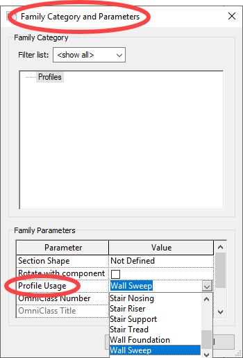

hello, I want to do a sweep for a wall, I downloaded the profile for the sweep, but when I go to edit properties and choose sweeps than adding a profile, the profile that already downloaded didn't show up how to fix that? thanks

Go to Profile Family and assign Profile Useage

What did you mean by assign Profile Useage? Thank you for the answer
Nachricht 4 von 6
als Antwort auf: Yara-architecture
The profile needs the right category.  Barthbradley shows how to set it. Edit the profile family and set it to the correct category.

hello,i found out that i picked up the wrong type of family,thank you for the answer
