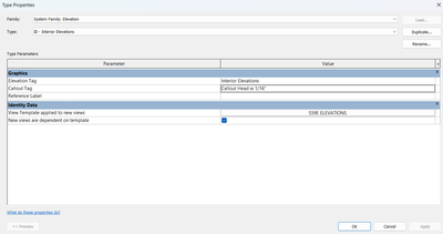

It's not a family since I got it from the elevation tab in revit itself (under view). I've tried to edit the text size but it there is not setting to change it.
gballam
Here is all i can see/edit. I changed it to 1/16" but that didn't do anything.

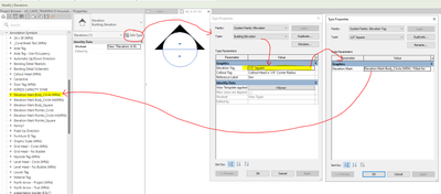

hmunsell
You're looking at the Elevation Type properties. The elevation family is a little deeper.
the family that needs to be edited is in the Project Browser.
Howard Munsell
gballam
wow i didn't even realize this was a feature. let me see what i can do with this info. thanks a bunch!!
