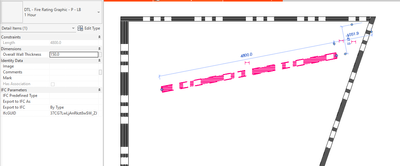

I have a line based detail item family with filled regions in it representing the different patterns for fire ratings.
Problem is the pattern (drafting) does not stay aligned with the family.
In the project I use a filter to apply the same pattern to walls in plans and with those they do align.
The selected item is the family and everything else is a wall with the filter applied.
Is it possible to have a drafting pattern in a family rotate with the family?

It seems there is not way to have a drafting pattern in a family keep its alignment to the family if it is rotated in the project.
