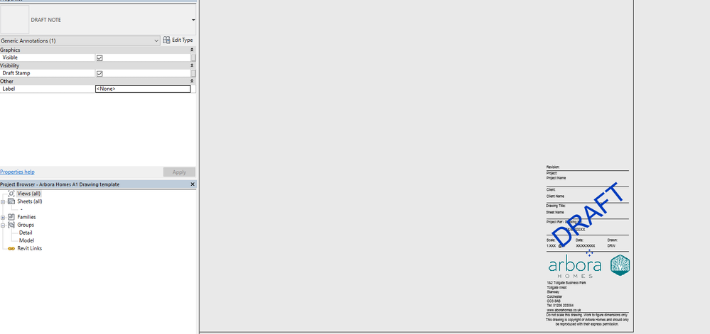

Hello i am trying to create a draft stamp which i can turn on and off on the drawing, but when i try to load my created parameter i get the below error.i did create it in generic annotation family so i am confused..DRAFTNOTE.PNG

ok 80% of the way there i have created the parameter in the family part (see attached)but when i come to associate it in the template i cant see the parameter? i dont need to created it again i presume? my understand was it would appear in the list.??draft.PNG

yes i have done this and it works in the family but when i bring into my drawing sheet it doesn't show the parameter there to associate it there. draft.PNG

so it turns it off in the template but why doesn't the visibility parameter appear in the properties list when i load into a project?draft x.PNG

ok this is my problem visibility doesn't appear in properties when i select the list? i have attached my template

Ok I see what happened here.
You added the visibility to the Draft text family but not to the title block
If you remove the visibility parameter from the Draft text family and add the visibility parameter to the title block,
and associate that to the Draft text it will work.
AJ.
