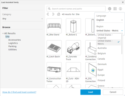

There are a couple loaded with the default Content in the U.K. these are in the following folder;
Site > Drainage > RWP (Rainwater Pipe)
You can search using Insert Tab > Load from Library Panel > Load Autodesk Family
You could also try other regions too
