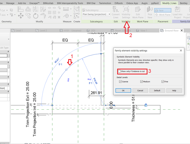

mauricio_mssf
One possibility is that your door is lower than the cutting plane so that the lines do not appear. Go to edit the family, select the lines and change the visibility setting.
Or This family may be configured not to appear at a level of detail like Coarse o medium, Go to edit the family select the lines change the visibility setting.
