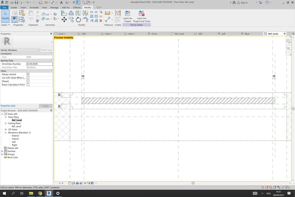

Hello Everyone,
I have created a door family. I have used the "Sweep" tool to make the door frame. When I see the object in the plan view and Hidden lines mode, I see the right section from the door frame (Image 1). But when I load the family in a project, I can't see the correct section, as you can see in Image "2".
I made this frame using an extrusion tool, and the problem above did not appear. I would like to know how I can fix this problem with the Sweep tool.

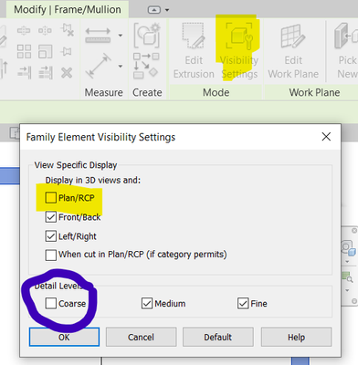

Switch view to medium or fine and check other view to see if that changes anything...if it does then it would be the Visibility Settings of the element in the family...

It is Visibility settings .. you are selecting the wrong element (your frame is set to not visible in plans and RCP)
It is a nested family (Generic Face based) Edit it and make it shared...then it will be cuttable
AT the status bar .... there is a Bulb icon which lets you see  a preview of how the family will look like when loaded into model. This can help you identify more or less the elements which need attention

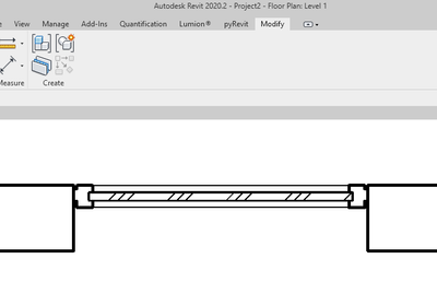

mahanmotamedi1991
As you can see here in the preview mode the object looks ok. But in the project it is not the same as preview mode.

  1. Make it visible in Plan and RCP first
  2. Then Edit the nested frame family and make it shared...
  3. Reload into Window >>> Reload into project
refer to previous reply

See revised family.  I created the sweep directly in the window family for now.  If you want to nest the frame, maybe model it as a work plane/level based/always vertical family, not as a face based family.

Thank you very much. I think the problem was that the nested family was not shared. Because before this, I activated the PLAN/RCP, and it didn't work.

If you want to use a nested family which isn't shared, built the nested family from the "Generic Model" template and not the "Generic Model face based" template. The orientation screws up the cut functionalty in the Door Category family (also for Windows category).
Or use @ToanDN solution of making the nested family shared or model the frame directly into the door family.
