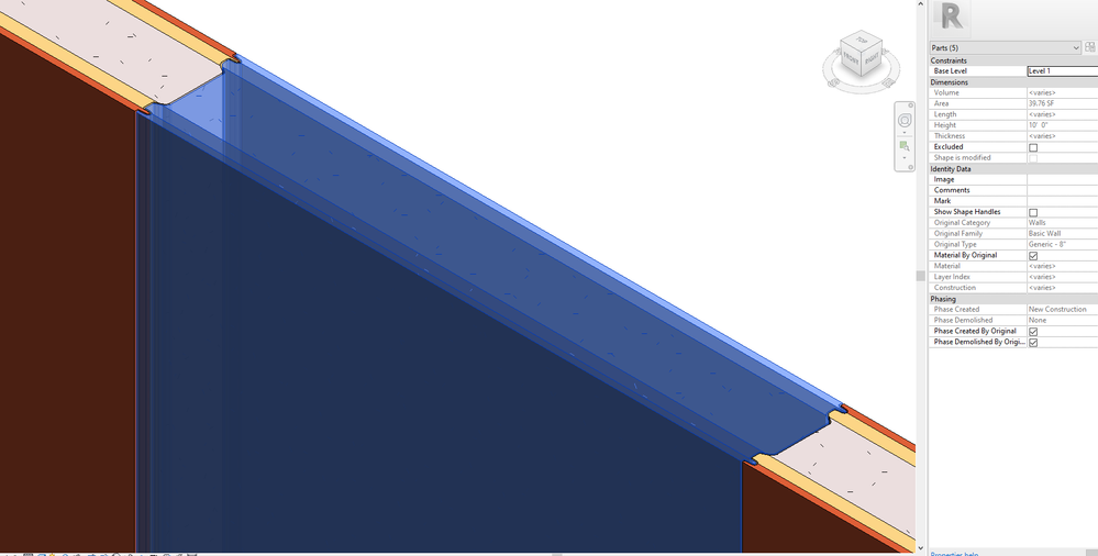

Yes to see how you are cutting the wall and with what...from what it sounds like, you seem to have divided all 3 layers/parts using 1 division line and you are using 1 Divsion Profile...which wont work
Note: To divide that you will need more than 1 profile...you cannot divide the 3 layers using the same profile.
  1. You will need a Division profile for the core and another for the Finish Layers (IF they are of the same width).
  2. If the finish layers are of different width then you will again need a different profile for each
  3. And you need to divide the parts separately not the whole wall with 1 division line. (Reason: you can assign only 1 profile per division. Meaning, different part width = different division)
Example below...I am cutting the core with a simplified DP like urs, then the Finish layers separately using the same D (Flipped on the outer layer)

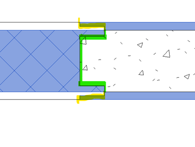

It depends on the number of layer you intend to divide...If it is 1 layer you just need 1 if it is 4, it will depend on the width of each.
As for the profile family you attached, It has a flaw ...There is a gap. You need to extend the lines at top and botom to reach the strong references
After extending the lines..it will cut perfectly

See the assembly image in previous reply no.13 ... .rvt is also attached therein
  1. Enabled Shape Handles and extended layers as needed
  2. I divided the core and I used the profile you attached after fixing the lines (placed 2 division lines Start/End)
  3. Excluded the end portions to eave the middle part which shows above
However, implementing this for the whole project would be quite tedious. I do not believe that this tool/option was intended for modeling the entire project with. It is meant more for generating particular details and not 900+ wall elements
