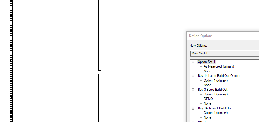

I'm not too sure what will all need to be known, and excuse the lack of official terminology in my repertoire, but I do very basic drawings in Revit - floor plans only really, and I've added a little screenshot showing the design options and the issue I'm having. I welcome all suggestions, on a fix or even if I should be using a different process. I appreciate you taking the time to read.
I utilize design options to separate each bay in large industrial buildings. I have the main building drawn in the primary option, then I have a design set for options which I design, and then I add another for actual confirmed tenant build outs - seems to generally work, aside from the fact that when walls intersect, even if the walls are on another design option that isn't turned on in my view, the wall on the design option that is turned on gets a little cut through it. To now I've been literally drawing in lines to fill in the spots thinking this must just be the way it is. Today I thought I'd ask to see if it is in fact the way she blows or if I'm doing something wrong? The wall with the piece missing, that is shown in my image, is on the "Bay 14 Tenant Build Out" design option, and the wall that is doing the cutting is on the "Bay 14 Large Build Out" option (that is turned off in my visibility/graphics), neither of these walls exist on any other option set, and I've not used any other Revit fanciness that I can think of.
I hope I gave enough info to know the problem, thank you!

I can readily see the issue. That wall is not continuous. It is intersected and divided by another wall in the Main Model.  Split the wall at the intersection and make the Door wall continuous.

That is the problem.  Elements of different Options in ONE Set will not interact with each others, but they do with all Options of other Sets and the Main model.  Turning options of other sets off has no bearing on what you are trying to get.
Technically, when things criss-cross like that they should be under the same Option Set.
