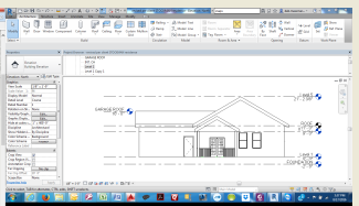

I have a level that says 'roof' at 11'0".  that is actually where the roof starts;  the peak is at 21'2 3/8".    the elevation mark is colored black and I cannot seem to change the text.  I actually see no reason for this particular elevation makr now that I've added 'level 5 and want to change the name of it to 'roof' ---  can you tell I'm new at this?    what's the trick?
Message 8 of 18
Can you delete it? BTW, you screenshot your message.
Message 9 of 18
deb_messmer
I tried but cannot. I know re the message on the screenshot - I have 2
screens/it always does that, lol --- did you see the picture? You may need
to scroll to the right to see it

Highlight the ROOF elevation level and screenshot so that I can see its properties window.

Sorry but we are not in CSI shows where they can just zoom in anything and find a clue.  Below is how it looks.  When you insert an image, choose Large size.  If you want to attach it as a file feel free to do so.

HilaryRomaniuk
You should be able to go to any view that show the level, select it and delete. If you get a message that says "this will delete all corresponding views" that is good & means you have successfully deleted the level, not just the floor plan.
HOWEVER, sometimes you cannot see the levels, for whatever reason, but if you click on "view> plan views" you can still see the levels, meaning they are still inside the project somewhere. To forcibly delete this *invisible* views:
Create a new level schedule ("View > schedule > Level"). Add the category "name" to the schedule and click okay. Now you can click on the level category and on the top menu ribbon select "delete". This will delete the level from the project even if you couldn't find it in any views.
Took me a while to figure this out! Hope this helps!
