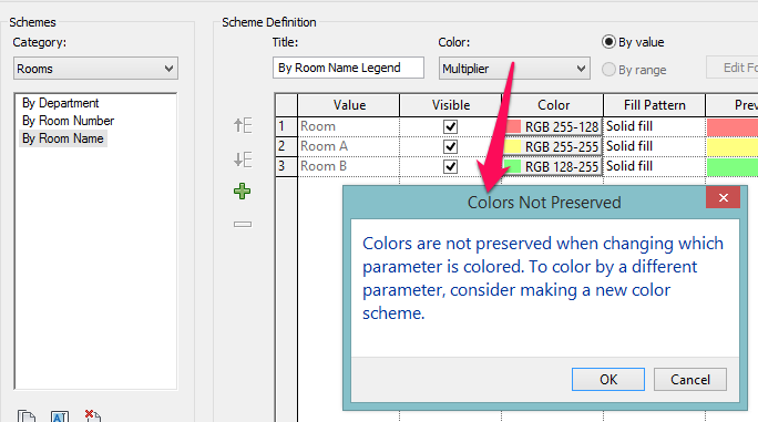

Maybe I am missing a step, but I can not replicate what you are referring to (Revit 2016).
When using the properties pallete or the ribbon I am presented with the same window.
Are you doing something differently? Other Revit version?
When I change other color schemes it does not influence my room name color scheme (with modified colors).
Only when I try to change the parameter for the room name to something else I get an issue. However before that I am warned of the situation like this:
Maybe you can make a screencast so we can see exaclty what is going on and try to replicate it?
