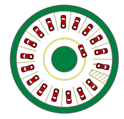

Message 8 of 9
lucdoucet_msdl
The circle of life? 😜
Message 9 of 9
The larger point of my contribution, is that every single one of those "wedgies" are created by radial-arraying the OOTB "9' x 18' - 90 deg" Parking Space Family.
