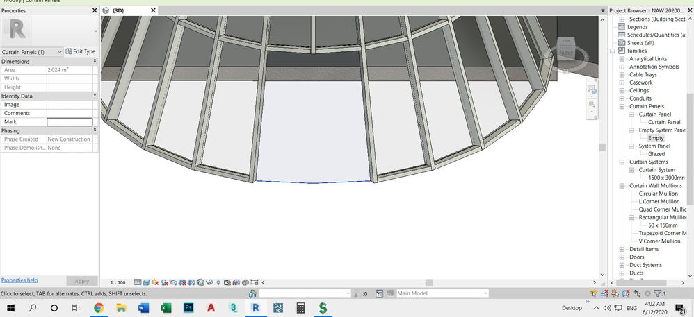

Hi
There is a panel I can't replace it with a void option.
I created a Curtain Wall with -20 degree, I want to remove a panel of existing (the big one in the center). I selected and then I clicked on Edit in Place, I selected Void from the Properties Panel and Finish Model, I had a message window with 1 option is to delete the Panel which is what I did(photo 4), Then I received another window message of Empty Family (photo 5), I chose Yes to continue, to have a new error message about missing a Panel with 1 option, which is to replace it (photo 6). I have this same problem and the same messages with both Curtain Wall Exterior Glazing and Storefront. I suppose I will have the same result with Curtain Wall Type too so I didn't try it.

No such thing as a "void" curtain panel. Replace with Empty System Panel.

Select the Panel you want to Replace, Unpin it, and look for "Empty System Panel" in drop-down selector. Should be there.  If it isn't, go to the Project Browser and find "Empty System Panel", right-click on it and press "New Type" to create one.

Empty System Panel and Empty Panel are different and only the former works for non rectangle shapes. If you don't have it then you need to transfer project standards from the imperial or metric architectural template to bring it in.

I created the Empty as per your illustration. But this has no effects on my panel. As per Toan I should not edit in place, even without that I can't find the Empty option anywhere when the panel is selected.
I'm using Revit 2021

zs-17
The panel is selected and unpinned. Where can I find the drop-down list?

SELECT the Panel and check its PROPERTIES.

If you notice my previous photo, when I select the panel this option will be in gray or dimed, I can't open it to select the Empty option I created. Neither in Edit in Place.
Message 20 of 29
What you are showing in your previous screenshot, is the Empty System Panel in the PROJECT BROWSER -- not in the Properties.  TAB-Select the Panel, Unpin it and look on your Properties Palette/Type Selector.
