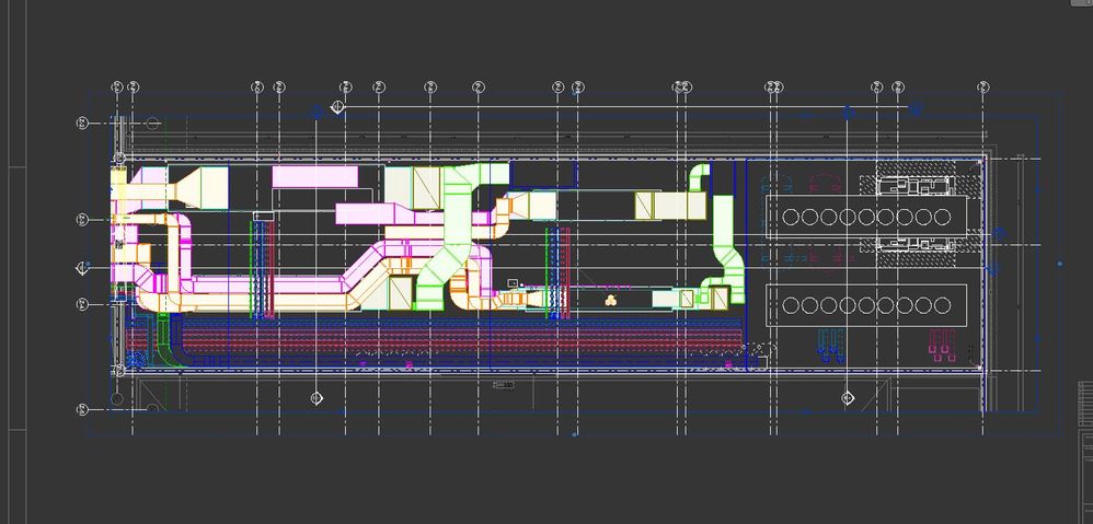

i have a problem, i don't understand why i have a crop view but the total dimension of view is bigger...

The inner boundary is View crop region, the outer boundary is Annotation crop region.

Why the view is so big if i setted crop annotation?

Annotation crop is to show the annotation outside of the cropped model.  you can click on the View crop region and stretch them individually.

In effect is so...But the result is different...
Crop annotation:
View in sheet (red view frame, green crop frame:
