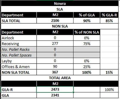

Hi, I have a schedule that I were using it for every project in Excel. Now the company is moving to Revit. So is that a way to make the schedule in Revit same like in Excel. I have attached image of  Excel shcedule.
Basically,
  • SLA Total is the total area of selling department in the store (example: footware, menswear, womenwear, bedding etc).
  • Airlock - Office & Amen is Back of House area
  • NON SLA Total is the total of Airlock - Office & Amen
  • GLA-R is the total of SLA + NON SLA
  • GLA is the total area of the whole store
2,454 Views

denisyukJ
Hello, @Mat.Syaf
Revit doesn't give you such flexible opportunity to make a schedules. I guess you can standardize schedule format in Revit and formatting data according your needs with a macro in Excel.

MachielAEC
I would create that as a Generic Annotation family, you can create it as a calculator in the format you like and the - similar to excel - type the info produced from Revit.

constantin.stroescu
you can do it in Excel and then import into Revit...
have a look at my screencast:

Mat.Syaf
@constantin.stroescu Thanks for the screencast. basically what you showed is you export the schedule from revit to excel, then import back to the revit right? My issue is to create the schedule from the revit itself. I need to create the area schedule but in the vertical way like the one in the excel. What I understand right now, Revit don't allow to make schedule vertically.
I've I manage to extract the area but the schedule will be in horizontal.

MachielAEC
Yes, Revit does schedules horizontally.
The way I do it is to have the normal schedule that provides me with info and then I input those values into a Generic Annotation that represents the 'excel look'.

Mat.Syaf
Interesting. How do you link paramaters in both schedule and generic annotation? For example, in the schedule, I have created a formula parameter which has formula that combine a few of parameter. How to import that parameter into the generic annotation?

MachielAEC
Currently it's a manual thing, I only need to type this once or twice per project so no need to automate it.
If I had to do Automate it, I would look at using Dynamo that will transfer information between the 2, however this becomes more complicated as the information per project might look different.
So currently, it's not dynamic at all or automated.
