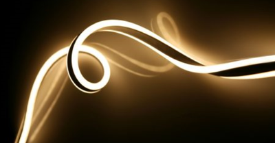

Hey man, so I've been playing around with what you sent (thanks again) and while it does allow me to place individual fixtures on the surfaces of the stair (very cool), what I really wanted to do was use the curving geometry of the stair's handrail as the basis for a model-in-place continuous tapelight family, a single fixture that follows the curve, something like this:
forgive me if I'm missing something in your solution

That's exactly what the family I posted does. The Rope Light.rfa places a strand of lights between 3 points.

So, this family creates distinct dots of light, exactly like a rope light. However, I would love it if it appeared more continuous like a real encapsulated flexible tapelight product
How might that be achieved?
Also, where would I add an electrical connector?
Last question; is there a way to calculate the length of each "strand" so I can assign a W/lf value to the type (that we use to generate an instance-based Apparent Load)?

You mean like a cold cathode gas-discharge light effect?  You might get a satisfactory result by using an Asset that has a Self-Illumination Property for the Light Fixture Geometry's Material.

yes, like neon. However, I am less concerned with the light source aspect of the fixture and more with the length and W/lf parameters.
