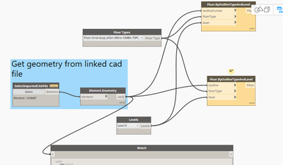

Hey ,Thanks for answer but my file is more topography made by floors to we able to seperate to parts for BIM purposes,
I am having profile as below from element geometry:
but having trouble to create froor from it :
