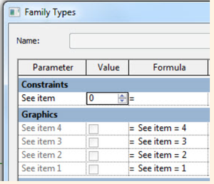

For this example I am trying to shut down two of the three Transverse top bar variants (in a detail component) if one of the three is ticked off (and vice versa for each).
Any Ideas?
Example below (which would not work when I tried it as it was citing circular references)
or(not(Transverse Top Bar 180° Hook), not(Transverse Top Bar))
or(not(Transverse Top Bar 180° Hook), not(Transverse Top Bar Hook))

Have you considered creating types, instead, where you pre-set all the proper choices for each type?

OK, thank you for that information. Please search this forum for similar posts on this subject, in which I have proposed to use integers to control the visibility of multiple parameters. It is difficult to do it with the approach that you're using. The other approach with integers assigns the visibility to a numeric value that corresponds to an integer parameter that controls the visibility.

Here: this should take you to post # 8 in the thread, where you will see an image:
https://forums.autodesk.com/t5/revit-mep-forum/if-then-formula-and-quot-yes-no-quot-parameter/m-p/38...

This linked method will work great on the more complex families I have.

In addition to the method shown in my previous message, it is possible to add the value of IF statements, like this:
