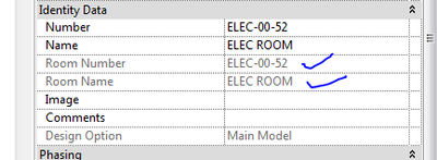

Hi @Anonymous ,
Try like these
First Add all Spaces wherever the room are locating and later By Space naming get the data for the spaces from rooms
Later u can proceed with your export
Check ,is that Space is Assigned with the Room Name, Room Number instead of Unoccupied
