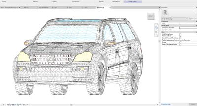

  • I have tried to "uncheck" always Vertical under Family editor.
Is there any way to convert the model to something I can rotate freely ?

Edit family, uncheck Always vertical, check Work plane, load in project and pick the sloped surface of the ramp or floor to place it
.... additionally, you can draw a ref plane on the elevation, name it, and place the car on that plane. Then you can rotate the plane to the slope you want and the car will follow.
