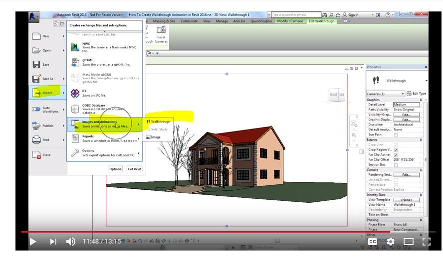

Can you make sure you have selected the view and walkthrough path? Please see step by step process in this article HERE
See video below on :
Revit Tutorials: Walkthrough
[video]
See Export options below:
Also, see the video below from 11:44 to see export settings, like length format (full frames etc)
