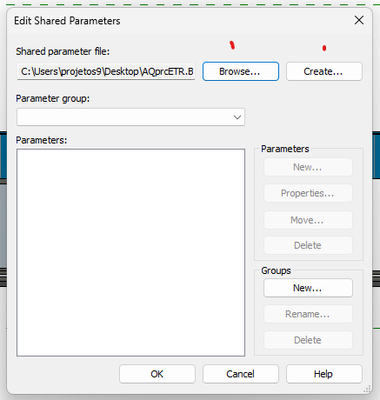

vitorbortoncello
Yes.
https://www.autodesk.com/support/technical/article/caas/tsarticles/ts/25inSqC92qlzFgTJHYtXHA.html
or just browse to the one created and load (.txt file):
