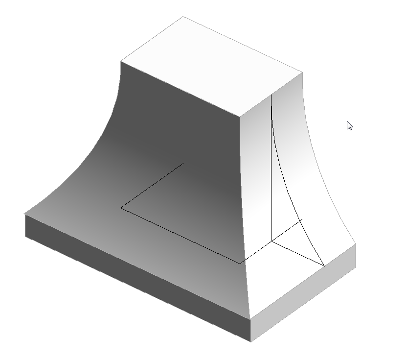

I am new to Revit and I cannot for the life of me figure out how to model this range hood. Anyone have any idea how/if I can accomplish this? I can't figure out how to finish it.

Are you talking about the molding. Use Sweeps for those.  Should be easy breezy.
If you mean the whole thing; it's modeled with a bunch of extrusions.  Open the family, pick an element and click on Edit Extrusion on the Contextual Tab. You can then see the base sketch for the extrusion shown in pink.
File attached.

Check this out you will get the idea.
Hey Thanks!! The curves were throwing me off but it makes sense how you did it. Really appreciate it!
You can do the same thing a lot faster and easier with one, single Sweep too.
Check out attached.  Less Calories. Less Filling.  Smiley Wink
