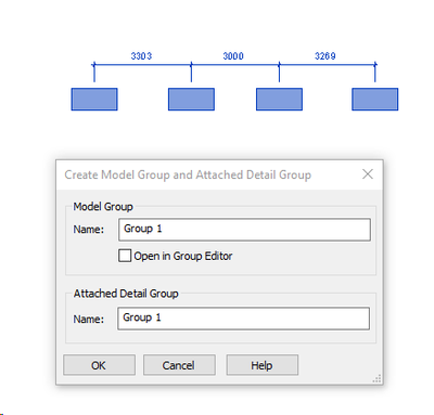

When you Dimension things inside the group edit it will be separated as attached detail group so all the warnings you will get ride of it
Or use a small model line LI as reference outside to the dimension both work well
