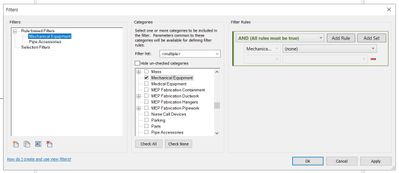

  • After that, I create a filter (let’s use one without any conditions for this example). In the filter, only the Mechanical Equipment category is enabled (Screenshot - 4).

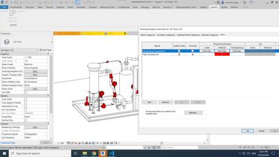

  • Then, I disable the visibility of this filter (Screenshot - 5), and in Screenshot - 6, you can see that the entire family disappears, including the shared nested families, even though the filter doesn’t affect them.
  • I believe this is a bug, and it shouldn't work this way.
