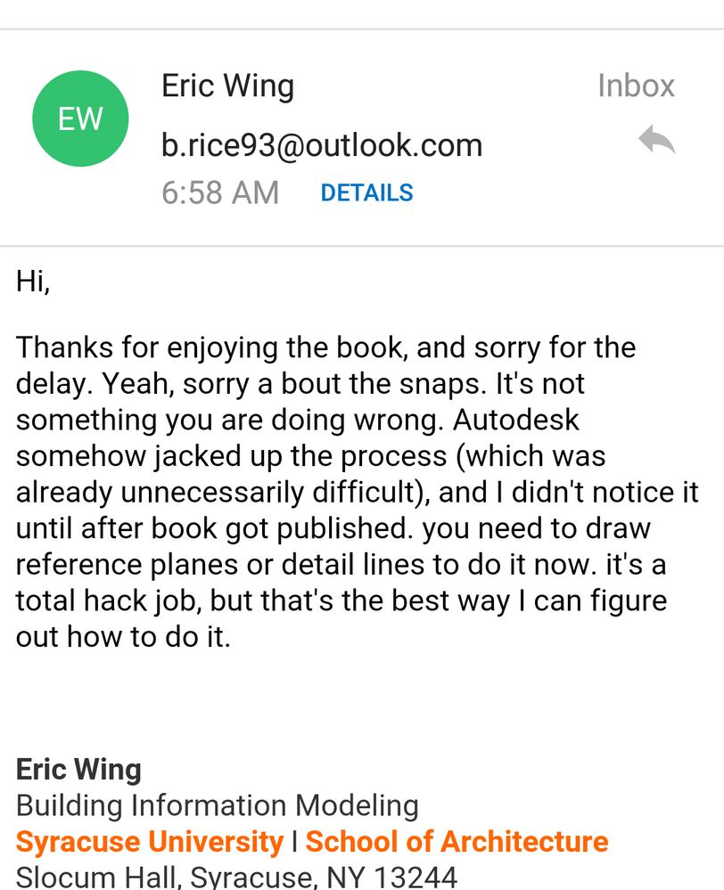

this was response from the author of the book

There are better ways to dimension angled geometries than drawing reference planes.  Below is one.
